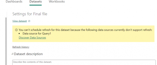

Do we need to install a gateway if we use power bi (connect to NXT)? Where can I see the last time the report was refreshed? I have this message in the power bi portal:
Hey @Veronica Krivis, yes, you do need a Data Gateway installed in order to set up scheduled refreshes of your report through the Power BI Service. If you don't set up a gateway, the only way to refresh the report is to go into the Power BI desktop file that was used to create the report, refresh the data, and republish.

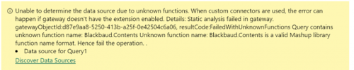

@Matt Thacker Hi Matt. Attempting to refresh a data source after installing the gateway using your instructions from September. The gateway is installed and seems to be working but doesn't' appear to be properly configured. ,I receive the following message when I click on ‘Discover Data Sources’ in the Power BI service, for example. Any thoughts on troubleshooting? Thank you!!
