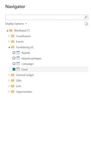

I have a Power BI report that I use for annual giving statements (so I haven't used it in about a year). I loaded it up today and refreshed the data, and everything loaded except the Funds table, which gave me a 403 Forbidden error.
I can't figure out why this would be happening, as the user that I'm using for this report should have rights to that data. Here are some things I've tried/confirmed.
- The connector is using the Fund List endpoint to load this data
- I can successfully call the Fund List endpoint using the same user if I use the Try It button in the SKY API documentation
- I can also successfully use get a list of funds using the List Funds action in Power Automate, using the same user
- I tried recreating the Power BI connector from scratch
- In analytics, these are showing up as blocked calls, but I can't get much more information about them
Any ideas?
@Matt Thacker
Yes, that's the one.0 -
