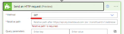

Looks like this is a Get request, so I set my HTTP action accordingly:
afb2224058ad470a4ee89af92e3a1289-huge-ht

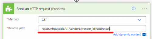

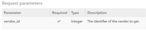

Let’s look at a simple example first. This request URL has a vendor ID request parameter in middle of the URL. The curly brackets let you know that it’s required, and if you weren’t sure, you can check the Request parameters area of the documentation page to see that it is required and read a little description about what it is.
029237ffec49ea574a6a931b3b871fc7-huge-im
f0aa65d23ecb1e46f4f443e9dec5f292-huge-im

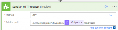

When you paste this request URL into your flow, you will have to replace those brackets with an ID, either by typing it in or by using dynamic content from another action.
9ce7cfff74e70fb369c0412b22c715ad-huge-im

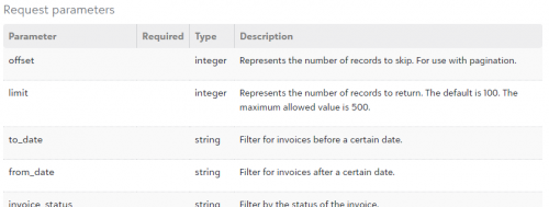

Next, let's look at a different example. This request URL looks a lot more complicated, with all the parameters at the end:
64c83f56404ff373a7777076aa0fbe5f-huge-im
But everything in square brackets is optional, so you can ignore anything you don’t want to use. Check the Request parameters section of the documentation to see what each of these parameters does.
bfeac0af38d21dc4a298231bae0ae2a7-huge-im

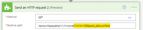

In our example, let’s use the ‘limit’ parameter to limit our list size to 100, and ‘post_status’ to only return invoices that have been paid. Because these request parameters come at the end of the URL, I can put them into my HTTP action like this:
0a40b8eebc7cfb7e68512722ad0027f7-huge-im
But it would be exactly the same request if I put them right in the URL like this:
6272157c509c80cfb8f4ba47e4220e03-huge-im
Either way will work, so use whichever is easiest for you.

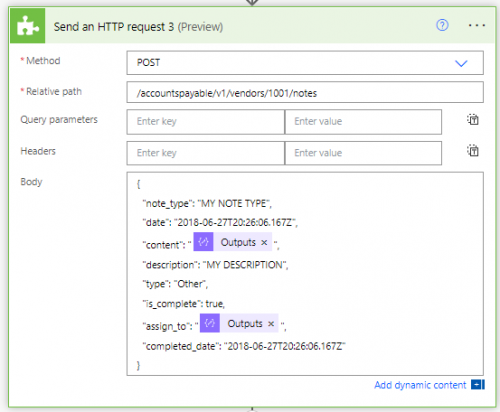

Request Body

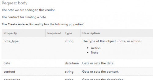

So far we’ve only talked about getting data. But if you want to create or edit data, you need a way to send that data to Blackbaud. This is where the Request body comes in. Post and Patch requests have a Body area where you can send the data you want to create/edit. But you have to send the data exactly how Blackbaud is expecting it, or it won’t work.
SKY API documentation has a Request body area that tells you what information you can send and which elements are required.
307f9fb26c183d54575ec01f68642465-huge-im

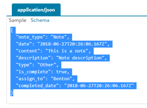

In addition to this, they also helpfully include an example request body, so you can see how the data is supposed to be organized. You can copy this schema right into your HTTP action and then replace the default values with your values – either by typing them in, or by using dynamic content.
7c91baa7cf739d251a6e3465d11e91b7-huge-im
7a7a5f51ac5e7c9fc8eeba3617bdfd39-huge-im
If you don't need to add one of these properties, you can just delete that line. Just be sure that each property line ends with a comma, except the last one.
There’s lots of room for error here. If you put a comma in the wrong place or use quotation marks where you’re not supposed to, the call will fail. But a failed call doesn’t mess anything up, so you can just look through your request body carefully and try again.

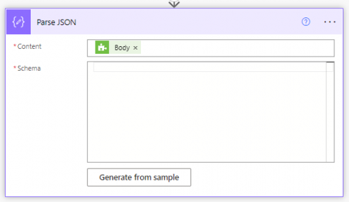

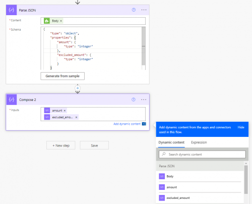

Add a Parse JSON action after your HTTP action and set the Content to point to the Body of your HTTP request.
56e20ba3b07bd4f400f75129362603e1-huge-im

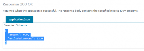

Setting the schema is easy because Blackbaud provides the schema in their documentation. Look for the area called ‘Response 200 OK’ and copy everything in the sample schema box. I chose the Invoice 1099 amount endpoint because the response schema is simple – most endpoints return more data than this.
7daab07f97cef2e949325657d1cf4f01-huge-im

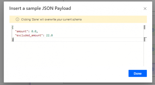

Once you have it copied, go back to your flow and click ‘Generate from sample’, and then paste the schema in there.
8974bebde6f2033bcc6566b5394a60b3-huge-im
Now you can access the data in the dynamic content list. You’re done!
