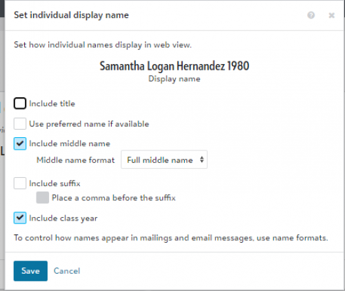

    I have one suggestion regarding your question about the particular requirements needed to make this happen in Power Automate. Create an endpoint to the display name configured in settings.
    The first complication I encountered was extracting the "display name." I was able to work around this issue by reconfiguring my settings to use fields I could access through RE Constituent endpoints. The configuration pictured below worked.

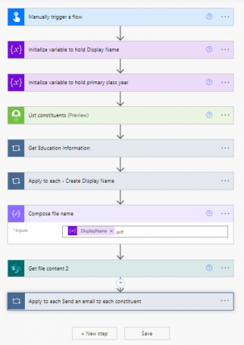

    I tried a few different ways to get the system to look for the file and attach it to the email. Due to my inexperience with the tool, I was unsuccessful and decided to go a different route for time's sake. (I need to have this done by the end of January.) The visual of the flow I built is pictured below. It DID NOT WORK, but I'm sharing it to share my basic logic.
    1. Set up:
      1. Download Giving Statements for a list of constituents from RENXT and save them to SharePoint
    2. Using Power Automate:
      1. Get a list of Constituents
      2. Compose file Name to match downloaded .pdf
        1. Requires that I also get the primary education information for constituents
      3. Get file content from SharePoint using the file name
    Send an email to each constituent with their specific file attached.
