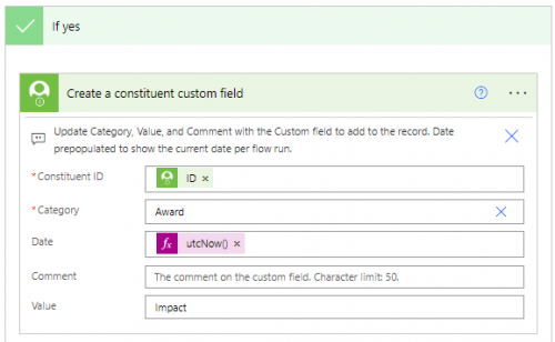

  • Update the condition and the Yes branch of the condition with the custom field information you want to add to constituent records when necessary.

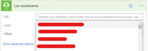

  • @Torie Wright - for the list constituents step under List am I supposed to put the name of my list or the ID number of my NXT site or what goes here?
  • Alex Wong
    Alex Wong Community All-Star
    Ninth Anniversary 1,500 Likes 2500 Comments Name Dropper
    @Joanne Felci

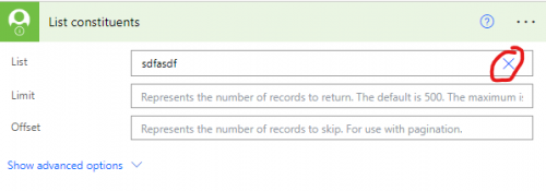

    if you see a X to the right of the field for List, click on it first.
    2d7666fafb1846ceb2a50bb257cb7053-huge-im
    Then you should see a “down arrow” icon that you can click on to see a drop down of list for you to select.
    64863ea69932127e2721eafd415032ab-huge-im
    the action is made such that it let you select the list with the name of the list, however, IF you ever going to use the “Enter custom value” (generally when you dynamically create a list, and want to get the list's constituent, you will use this option), then you will need to make sure you get the List ID, not name of List.

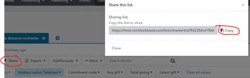

    Go to the list you want to use, and click on Share.
    61f0faa97bad2cc01d599853a37e4117-huge-im
    Copy the URL and paste to a notepad.
    https://host.nxt.blackbaud.com/lists/shared-list/1a23bcde-45b8-41ef-9451-3f07a0c54443?envid=z-abcdE1fghJkLm_mOpQrstuv
    the RED part is the List ID.

    the action to put the “list id” (or select from dropdown) is the “List Constituent” action

    I'm going to provide some change to the original flow that you download and import, and apply a little efficiency to the logic.

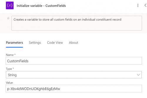

    Delete the following actions:
    • Initialize variable - CustomFields
    • Apply to each - custom fields from single constituent record

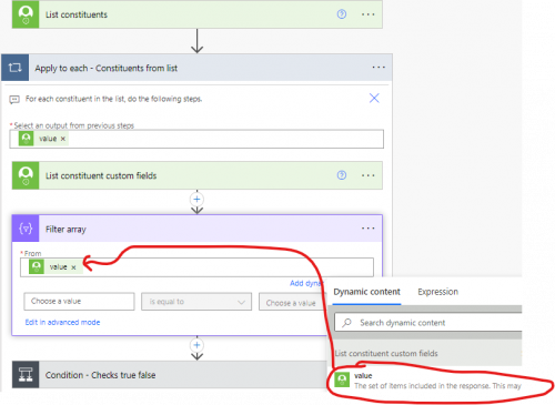

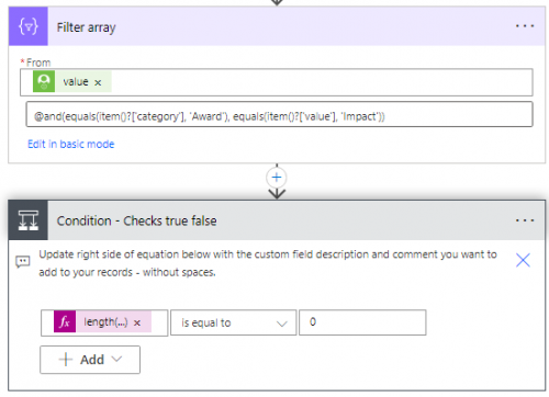

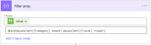

    After the List constituent custom fields action add an action Filter array and put the value (the one with the description that say “The set of items included in the response…”) dynamic content in the From field of Filter array
    b1486ceadc979d3e67f2a18b065ea4e9-huge-im
    Then click on Edit in advanced mode and paste the following in:
    @and(equals(item()?['category'], 'Award'), equals(item()?['value'], 'Impact'))
    1e2122b9c2b1163976e421475f340bf7-huge-im
    The Filter array action will avoid the need to loop through each constituent codes of a constituent and condition on result where the attribute category is Award and value is Impact.
    Next we will condition on if the filtered result is equals to 0, if yes, add the constituent attribute:
    73fe367e68c039dfc4b5fd3011b18f16-huge-im
    Go to the expression tab and enter: length(body('Filter_array'))
    07f9ff302107cabc406b56ba75bc333d-huge-im

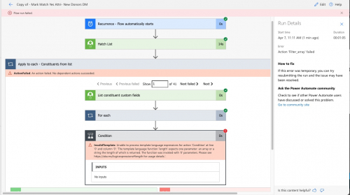

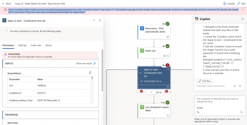

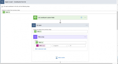

    I've downloaded and modified this flow as per the instructions, I think. I'm getting an early error at the Apply to each Constituents from List section.
    "Action 'Condition' failed: Unable to process template language expressions for action 'Condition' at line '0' and column '0': 'The template language function 'length' expects one parameter: an array or a string the length of which is returned. The function was invoked with '0' parameters. Please see https://aka.ms/logicexpressions#length for usage details.'."
    f4b7b266a6e04afd600dbd0ea43b512e-huge-ad

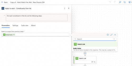

    I'm not able to pull up value. I have to choose body/value in the Apply to each step, so I'm not sure what that is about. It is probably causing the error.
    dfbf2b197e17441118e93f8cb27c227d-huge-ap
  • @Sean Pflueger - Hi Sean, I know you tagged Alex here but I thought I would start asking some questions. All I see in what you posted is a List Constituents action. Are you trying to add a custom field to those people? Do you need to check to see if they have the custom field already?
    It's hard to tell where it is failing. I think it might be looking at the count of constituents that are returned. Can you put in the length as it is?

    @Sean Pflueger

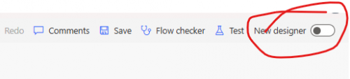

    Apply to each is 99% of the time not the reason for failure. The “new view” is really bad at guiding you to see where the real issue is for troubleshooting.
    From your error message, it is telling you that the problem is in the Condition action within the Apply to each, where the Condition action is using an expression length() which is failing b/c it was not provided an array or string to get the length of, you provided nothing (meaning, your expression is length() only, instead of length(dynamic_content_of_array).
    Show screenshot of the Edit mode and run mode of the Condition action in OLD view (not new view).

    @Sean Pflueger

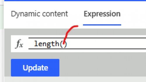

    As I suspect, your length() expression on the left side of the compare does not have any parameter passed in to check the length of.
    You will need to click on the length() dynamic content, and it should pull up the Expression editor.
    click inside the paranthesis:
    65f9ac3accdd7984bf31e21b87a0c308-huge-im
    and then select the “value” dynamic content that is from the list constituent action.
    HOWEVER,

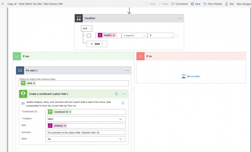

    From looking at your screenshots, your flow is in a mess with too many “for each”. From the screenshots, it looks like the flow is doing:
    • get constituent list
    • apply to each constituent
      • list the constituent custom fields
      • Another “for each” which I can only assume you are “looping each constituent custom fields”?
        • filter array, i don't know what you are filtering
    • condition
      • length() is equals to 0? (screenshot is blurry, so i can't see if it's 0 or 8
        • if yes
          • another for each - i can only assume this is looping constituent again…
            • create constituent attribute/custom field
        • if no
          • nothing
    you have way too many “apply to each/for each” loop that is not needed but will cause your flow to run for way too long even if you corrected the error mentioned above. If I understand your intention of the flow, all you need is:
    • apply to each constituent (for each constituent)
      • create constituent custom field
  • @Alex Wong
    Thank you. I simplified and took out a lot of the steps and it appears to be working. Thanks.
  • @Sean Pflueger- it's still hard to see your screens but I think in the Condition you want to have the length of the filtered array which is explained in the posts below. Is this what you have in your condition?
    Also, I think you need your condition inside your For each loop, it appears to be outside. If you still are having issues, join us tomorrow at the Power Automate group and we can help you. Email Erik Leaver to get on the agenda.
