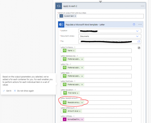

I've been trying to create a custom letter for acknowledgements and am running into an error when inputting additional fields.

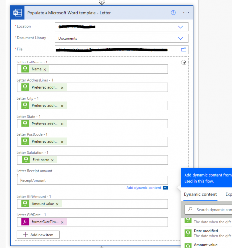

Working from the default flow listed here I've created a letter that will include a receipt amount. After following the steps from the Build Templates tutorial I'm finding every time I input the dynamic content receipt amount to the Populate a Microsoft Word template the flow automatically updates and creates an additionally nested “for each” loop. The same goes for appending the values to the array.
I've tried inputting different values in the field and some will cause the same error, however others (such as the Gift Amount) come out fine with no error. I have a pretty low-level understanding at this point of custom flows and editing things outside of the default templates so any help would be great.

The reason why you're running into that issue is that some aspects of the records behind the scenes support multiples, even if they're not actually in use right now, or if you only use one. For example, think of split gifts. Even if you don't actively do split gifts, the system behind the scenes still needs to account for that possibility. If you were to try to pull in Fund information for a gift, you'll see the same thing (automatically putting in a loop). If there's even the potential of having multiples, it automatically throws in a loop in order to account for all the multiples.
The next question is “if I know I'm only going to have one of X, how can I keep a loop from showing up?”. There is a Mini Skills lab (see https://community.blackbaud.com/forums/viewtopic/586/58330 ) that covers this scenario, with a focus on Fund Description and Payment Method. The same thought process can be applied to most anything else in the same scenario.
Here's what I did:
In Compose, I put in the expression item()['receipts'][0]['amount/value'] then formatted the number and dropped that into the template.
