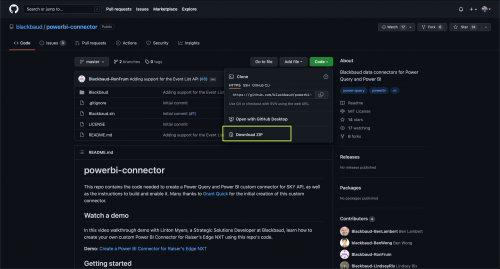

So the initial setup, is complete. I have the correct redirect URL in place. What I'm not sure of is step 2. I did download Visual Studio. I don't know how to use it. What does it mean when it says “Clone or download this repo locally”? If someone knows of a video link to this step that would be incredibly helpful. Thanks in advance.

You can download the files for the repo here.
That link will take you to the GitHub page where the repo lives. Click on the green Code button and then Download ZIP. Then the rest of the instructions should make sense from that point.
@Matt Thacker this is fantastic. Thanks a bunch!
