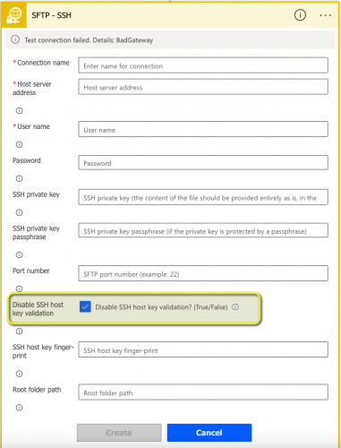

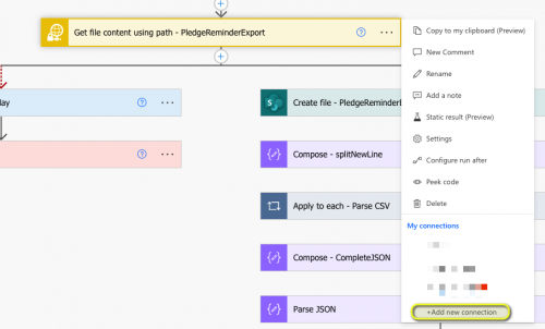

You'd be using the SFTP - SSH. You may have to click the three dots beside that action and create “Add new connection”. Accessing this isn't the same as the credentials you use to log into RENXT.

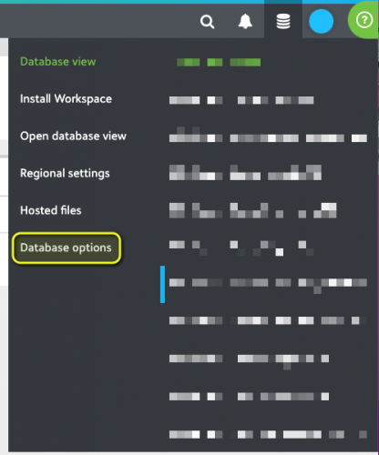

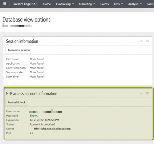

With the screen that shows up from there, you will have to enter the “FTP” credentials that you will have to get by logging into RENXT, Clicking on the “Pancake” / Database Icon at the upper-right, and then clicking on “Database Options”. (Our example environments are configured a bit differently than most organizations, so your menu layout may look a bit different).
On the resulting screen at the bottom, you'll see the “FTP Access Account Information” tile that will have your username, an option to “show password” and what the server name is. You will use that information to fill in the connection screen.
On the connection screen, when you put in that information, make sure you also select “Disable SSH host key validation”. You don't need to enter anything else that's labeled “SSH”, but make sure you put in “22” for the port number.
In regards to the code within the URL, you put that in the “Specific Folder” step.

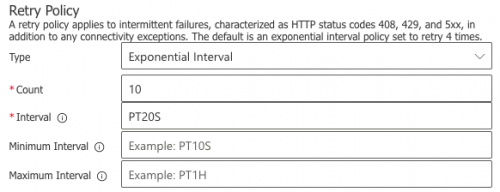

Great to hear it's working. Even in my setup it looks like it has to go through a few retries before it connects (that's what the ‘Bad Gateway’ is coming from), though not sure why. If you (or anyone else reading this) runs into a similar issue, you may want to try upping the number of retries. This can be done by clicking the three buttons on the action, then clicking settings:
Then under the settings, there's a Retry Policy that you may want to tweak. The default is 4 retries, here's an example of changing it to 10 retries with an interval starting at 20 Seconds
I have not validated the “sweetspot”, but thought to put one idea out there if others are running into the same issue. If you have multiple actions that involve the SSH - SFTP, you'll have to do this for each one.
