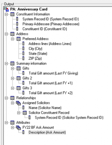

Before updating any flows, you will need to create the queries and exports you are using as part of this flow. Below is the output used for these flows. I also chose to create two CSV files, one for the flow of unassigned prospects and one for the flow with assigned prospects. We also have the Queue module, so we were able to schedule the export of the files we need, but it is NOT necessary to use Queue to use these flows.

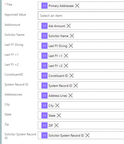

1 – Create a SharePoint List with the following columns. For Approved value, we created a choice column with the options of “Pending”, “Approved”, and “Do Not Send” with the default value being Pending. Please note that if you change any of these values, there will be steps towards the end of the flow that will need to be adjusted.

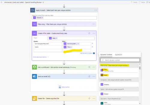

I'm loving these flows. One question--I'm wanting to add some columns to the HTML table in flow 2 that is sent to the solicitor. How do I add another column to this HTML table? I can't figure out how you added the SolicitorSystemRecordID or Title from the array in the previous step, they don't seem to be available in the PowerAutomate field selection pane0 -
@Matthew Young
there are a few ways you can do this, some easier than others depending on how familiar you are with JSON data object in Power Automate.basically in order to add more columns those column must first exist in the JSON Array you pass into the create HTML table action. You can either use the “addProperty” expression or create a new array that has all the properties you want.
@Matthew Young - try using an expression “items()” with a key “?['x']” tacked onto the end. You'll need: the output name of the field you're looking to include (look at a recent run of the flow to locate this), and the name of the apply to each. On the right side of the able add an expression “items('Apply_to_each_-_Select_each_item_per_unique_solicitor')?['x']” - replace the "x" with the name of the field to include; on the left side, include the header you want in the table.
When you first put this in, it will appear as an expression, but will change appearance to resemble the other entries above.0 -
@Matthew Young to add to what @Austen Brown mentioned, the “Title” option has the expression of item()?['Title'] entered and then will change to looking like it is a selection once you save your flow.
Also, the part of the flow that you will want to look at is the Filter array step where you can see the outputs with all the field names.
Thanks @Dan Snyder @Austen Brown @Alex Wong .
I was able to use the item()?['x'] expression in my create HTML table action to reference the specific fields in the array from the previous step.
