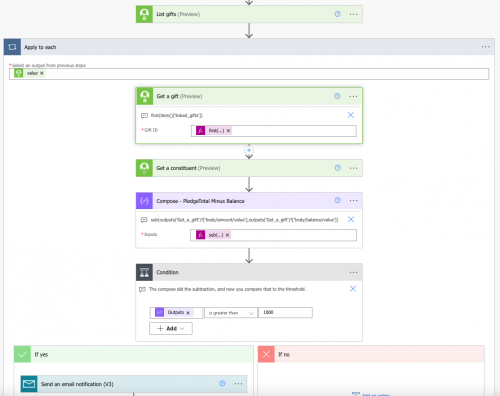

    The thing to keep in mind here is that Linked Gifts point up to the parent. So, you'd need to put together a flow like this (there are a few expressions sprinkled through, so you may have to rewrite these if your actions are relabeled differently than my example):
    • List of all pledge payments
    • Apply to each: Use the linked gift in the pledge payment to Get a gift the original pledge.
      • The Linked Gifts are in one of those random arrays, so you'll have to use first(item()['linked_gifts'])
    • (Optional) Get constituent to get the constituent information (to put in an email)
    • The Parent/Original Gift/Pledge has both the Original Amount Value as well as the Balance Value. Use a Compose and the “sub” (as in subtract) expression to find the difference between the two: sub(outputs('Get_a_gift')?['body/amount/value'],outputs('Get_a_gift')?['body/balance/value'])
    • Then use a Condition to compare if the result of the math above is greater than your threshold (in my example, it's only 1000, but change as you need).
    • If Yes, then do an email action to be sent with any details you may need to include. I did the “generic” email in this example, you can use Outlook. At this point, the result of the List Gifts has the information from the Pledge Payment and the Get a gift has the information from the Parent / Original Pledge.

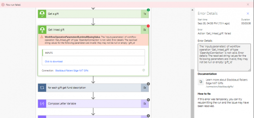

    Good morning! I used your method of “get linked gifts” to pull in the pledge balance for my acknowledgement letters. The flow ran successfully when I set it up a couple of days ago, but now I am getting an error. I've tried deleting and reentering the function but it still produces the same error. Any idea why it was working and now isn't?
    Below is the flow I have and the error it is giving me.
    e351f7af697cc1bd8d5d6034e9294604-huge-im
    flow with Get Linked Gift action
    e50de822f9533c28531a6074cd089e1a-huge-im
    failed flow error
    I think it may not like that some of the gifts in the list don't have a linked gift. How can I account for that?

    Linked_gifts are one of those things that I don't think so up at all if not present (not even null/blank). If you have a flow expecting those, then that can cause an issue. Check out https://community.blackbaud.com/forums/viewtopic/586/61118 that goes over a similar scenario and one possible approach for accounting for this.
