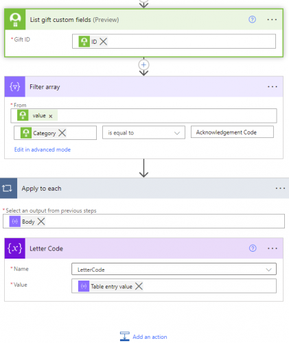

Just adding a picture to what @Evan Webb shared. Mine also only has one value and I ended up storing it in a variable to add to use with a switch later in the flow.

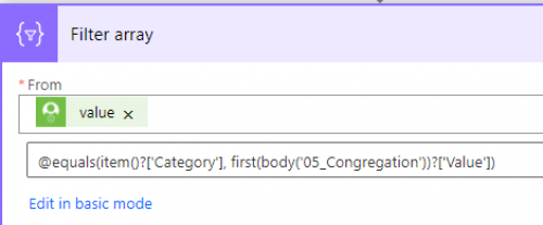

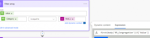

Evan, apparently something I am doing is still incorrect - do you see what it is by chance?
Error message: Connect to include a valid reference to ‘05_Congregation’ for the input parameter(s) of the action ‘Filter-array’.
The Custom Field Category is “05 Congregation” and I want to display the accompanying Value. this is what I am using:
Or in basic mode:

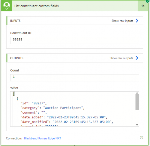

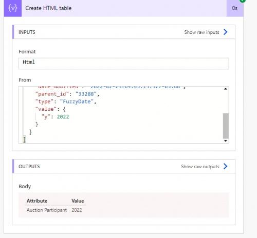

I'm using the List Constituent Custom Fields connector but the below process would be the same for any of the custom fields/attributes. When the List Custom Field action runs, it's going to return a list of JSON objects (like what I've listed below). Every attribute will have the same schema. So if you had more than one attribute for a constituent, it will be this format repeated. The easiest thing to do is to add a Parse JSON action after the List Custom Field action and parse what's returned. In the example below, I put the output into am HTML table but you can output the values anywhere.
One important thing to note: the key, value pair for value returns another object (key, value pair) so you cannot access the true value of the attribute by just using attribute[0][value]. You'll need to go something like attribute[0]['value']['y'].
