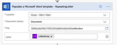

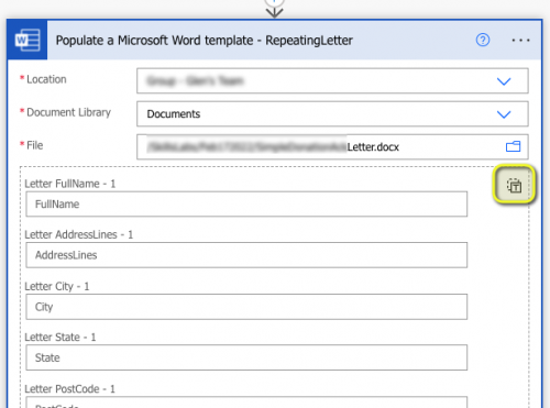

See attached! The first slide is the good one; the other 2 are bad.
Anna Zimmerman:
Thanks for this, Anna. For the letters that are erroring, did you create those letters from scratch? The issue you're running into is that those letters are not setup as repeating either they were created from scratch or the repeating part of the letter was inadvertently removed. To set those letters up as repeating, you need to:
- Highlight the entire content of the letter
- In the Developer Tab, click the “Repeating Section Content Control” button then save
- Go back to your flow, reselect that letter in the Repeating Letter
- If all you see is the “LetterArray" like in the “good” version, you're good to go.
- If what you see is the Content Control merge fields, then click the “T” to the upper-right and re-insert the LetterArray variable from the Dynamic Content. It should then look like the “good” version.
- You may have to reselect that letter in the Populate a Microsoft Word template - Letter as well.
