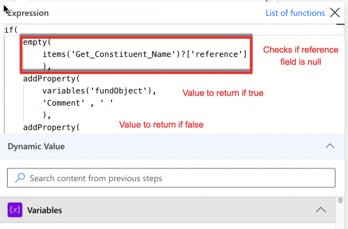

I would suggest using expressions over conditionals. Conditionals should be used more for error handling, whereas an expression using the if function will check a condition and return a value if true and a different value is false. Either way is fine, but using conditionals you might find yourself having to add a lot of duplicate steps.
Thanks, Matt! The terminology you used is probably more accurate for what I did, since I did use an expression:
if(empty(body('Filter_array_-_Contact_Name')?[0]?['relation_id']),outputs('Get_the_Donor''s_information')?['body/id'],body('Filter_array_-_Contact_Name')?[0]?['relation_id'])
Because this expression is in a “get constituent name format summary”, it would not accept a blank or null response (which is what I wanted).
