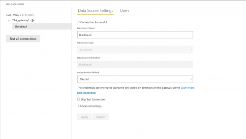

Not sure what an Azure Data Gateway is, but the connector is stored locally on your machine so the gateway needs to exist locally as well and connected to your PBI service. It should appear like this (we're RE NXT Azure hosted).

Hi, I'm Laurie, the DBA working with Iris. We are running the Data Gateway on-prem. I have uploaded the .mez file, from Iris, to the server, in the Custom Connection folder. Then on PowerBI, I try to set up the connection, using the generic Blackbaud ID account, and I can't get it to work. But I do see the Blackbaud connection, which I am selecting. We are using a domain account, and I think that it is getting messed up, as I keep seeing that it is trying to use my account, not the generic account. I read an article about possibly setting our Data Gateway service to run on a domain account. I haven't been able to talk to someone about making this change yet, but what do you think? Or any other suggestions? Thanks.
