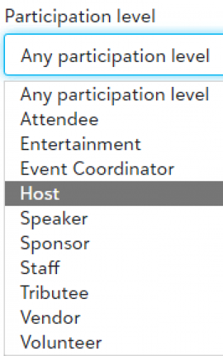

- What do you use for Participation Level? We added Host, Speaker, Sponsor, and Tributee, leaving everyone else blank. Is there a best practice for NXT reporting that others use for all attendees that aren't speaking or sponsoring, etc.?

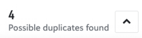

As for the non-constituent issue you're seeing in NXT, maybe what I've experienced will help. We actually have an event next week and I have had to add several spouses who just have a relationship record. What I've found is if you start typing their name to look up they come up as not found since they're not constituents (clicking “Add” to add a participant and then searching in the search field). When you click on the “+” though to add, then, and start entering their information you will get possible duplicates. If you expand that at the bottom of the screen you will see the relationship record(s) appear and can then select the proper one to include (same thing that happens if you are adding a new constituent in NXT but it also looks up relationship records). I have not found a way to do this in the DB view, though.

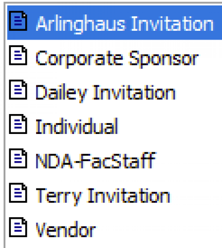

As for participation, I'm just starting to branch out with this. We have three honorees at this upcoming event. Each of them has a list of invitees so I've created a participation type for their lists so we know how many from each list are attending. Being a school our faculty and staff are expected to attend this so I also have a type to differentiate them from the regular attendees that are just alumnae or other friends of the school (Individual). I've also noted Vendors and then Corporate Sponsors, as our sponsors get a certain number of tickets based on their giving. Once this event is finished I'll mark the named invitations as inactive so they don't appear for our next event.

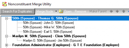

Miki, do you know if there is a way to merge the non-constituent participants into each other or into a constituent record? When I add a non-constituent spouse to an event, I may get 3 or 4 possible matches where the same person has been added in the same way to 3 or 4 other events. How can I merge them so that the spouse will be shown as having attended all these events?

Thank you, this helped! And sorry for the delay, it was so busy during the last event, that I forgot to replyFor anyone looking for the answer, Miki nailed it.
In NXT currently, a non-constituent can't be added as a Participant from the Event Participant list. They must be added as ‘Guest Of’ a constituent record (Named or Unnamed) or be a constituent. Using the (+) sign will allow you to search, and if a duplicate exists, select the duplicate from Miki's screenshot.

I have the following attendee types as of today, in case it's helpful:

@Heather Jacob I am so sorry I never saw your question last year.
In database view under Plug-ins there is a Nonconstituent Merge Utility. This allows you to find duplicate relationship records and merge them into one.
I used this several months ago to start cleaning up parishes we had listed in our database as relationships instead of them having their own constituent record and then linking them to each member we have (we are a school with feeder schools so we track this information).
There is a Knowledgebase article (41225) that helps walk you through the process. I was able to print control reports after them (I save them as a PDF on our shared drive) and they each list the constituents who were affected.

@Miki Martin Thank you for sharing the screenshot and kb for the Nonconstituent Merge Utility! I'll be trying this out today. Much appreciated!
