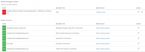

To demonstrate, this is the result I get when importing the flow:
The connectors are fine, and I tried to import the flow as new, but I still get a failure.

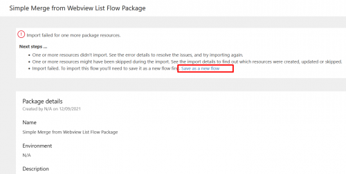

If you scroll to the top of the page, you should see an option to Save as a new flow.
Click on that and it should allow you to continue.

If the import setup is create as new, you may have an error message at the top of the page that includes Next steps. The last step has a link for “Save as a new flow” (highlighted below). Click on that and it should import fine.
That third bullet doesn't appear for me. I have tried this on multiple imports and the ones that have a Word connection all error with the same error.

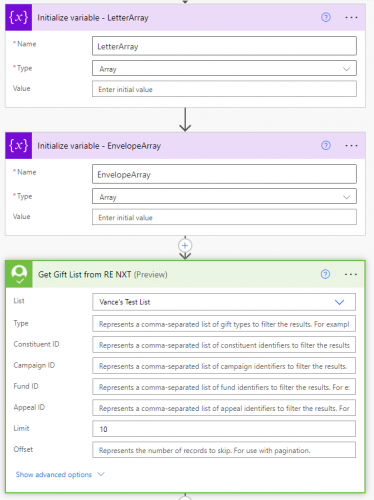

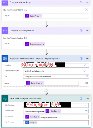

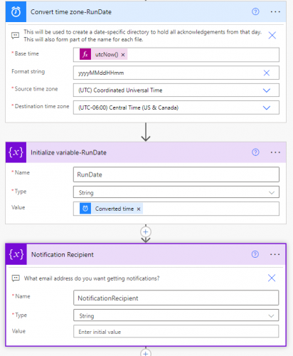

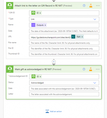

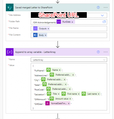

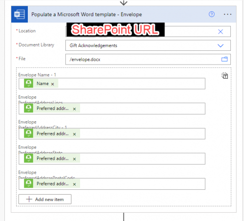

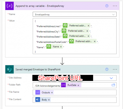

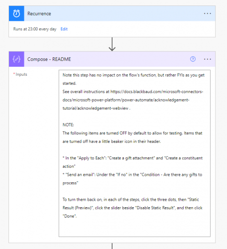

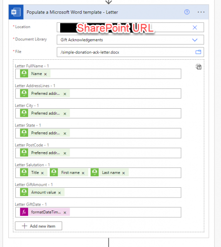

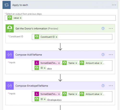

Here are screenshots of the workflow. There is a lot going on here. I got it working in a test scenario. I would be happy to answer any questions if the screenshots are not sufficient.
Vance Smith - would you be able to post a link to your template or share it please so we can see if that would work so others having the same issue can progress..
Attached.

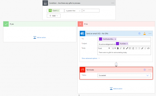

I got the same error when using your file. However, thanks for screenshotting the flow, that is super helpful. One question on this, for the condition, for the if yes, the rest of the steps belong in that path? Thanks again.
That is what the logic is doing but instead of putting all the steps in the “yes” branch, they are just manually terminating the flow in the “no” branch. Either way would have the same result.
