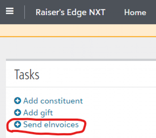

- Power Automate that is triggered by action button “Send eInvoice” on RE NXT homepage to do the actual sending of eInvoice eInvoiceAutomation.zip

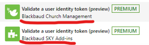

Our organization is not a church and so we do not utilize Blackbaud Church Management. Is there a workaround for replacing Blackbaud Church Management connector with just Raiser's Edge NXT connector? I'm having issues with connection during import of your eInvoice Automation file. Thank you!0 -
@Hannah Lee
You don't need to be using Church Management, my org doesn't neither.At the time of this post, the Validate a user identity token only exist under the Church Management connector, and it can be used for RE NXT too.
Now, there is Validate a user identity token in Blackbaud SKY Add-ins connector, so you can use that:
