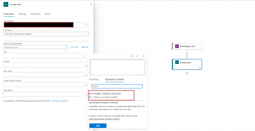

This is really awesome. One thing I'm struggling with right now is the power app now showing up in my Dynamic content.How do I resolve this?
@Subash Mahat did you ever get a response to this? I'm having the same issue.
@Shalena Stelzig and @Subash Mahat

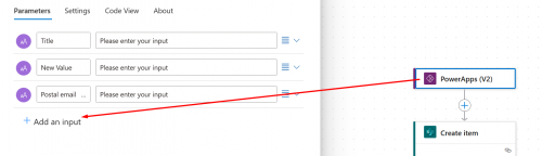

The difference here is that Trevor was using the original Power Apps trigger, but Microsoft has since deprecated that trigger and moved entirely to what is known as the Power Apps (V2) trigger. The main difference is that instead of calling each field using the ‘Ask in Power Apps’ option, each field is called as part of the trigger and then you can input those values in the corresponding actions below.
I've mocked up a brief example to demonstrate.
Here on the Power Apps trigger, you add Text inputs for each of the values that were previously added via Ask in Power Apps (I only added the first 3)

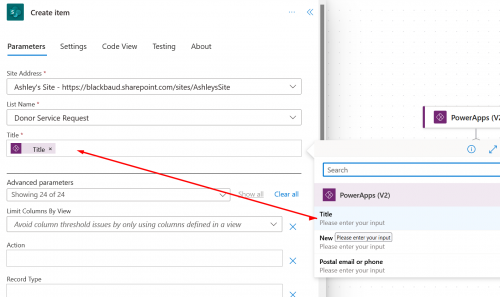

Then in the SharePoint Create item action, I can grab my named input from the Dynamic content window and add it to the appropriate field in the SharePoint list.Give this a try and let me know if you have other questions!
