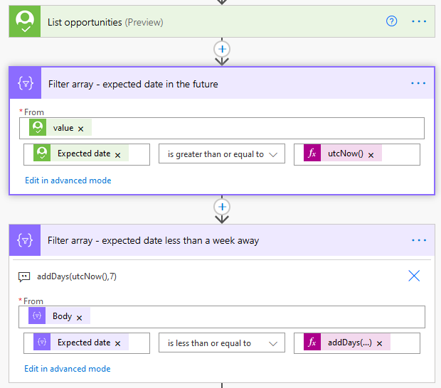

Here's how it would look with two Filters:
The first filter looks at the Value from your List opportunities as the source. Then it looks for any items where the Expected date is greater or equal to utcNow().
The second filter looks at the Body from the output of the first Filter. Since we've already filtered out any items where the expected date is in the past, now we need to filter out items where the expected date is more than a week in the future. We do this by using an expression to get the date 7 days in the future. The expression looks like this: addDays(utcNow(),7)
When you want to use this data, make sure your using the output from the second filter, not the original List Opportunities action or the first Filter action.
