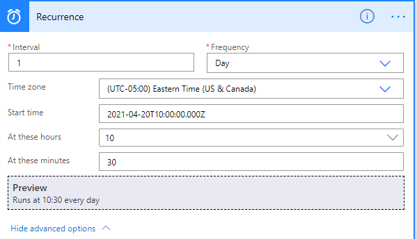

Hello, I am working to get a simple flow as shown in the tutorial to work, e.g. grab an NXT list and email the information. I started the free trial in MS, setup the flow and it will work if I run or test the flow. However, the scheduled recurrence portion is not working.
Do I need an "official license" or is there something about our RE/NXT setup that is preventing this from fully working?

Jana Littleton, would you be able to post a screen shot of your flow? That may help with an answer.0
Dan - I got it to work - I did not realize in the start time box, that you should put in the local time to begin the process. So once I put in 10:00 AM it fired an email to me at 10:30 AM. I assumed the Z at the end of the datetime there reflected some standard time zone.
I am assuming though, after my free trial expires I will have to contact my IT dept. to get a proper Power Automate license? I am assuming if I am the only person in the Org creating these flows I only need one seat?

Great, glad you got it to work. In terms of the licensing I would talk with your IT department as they would provide the best advice. I am not in IT so can't really give good advice there.0
