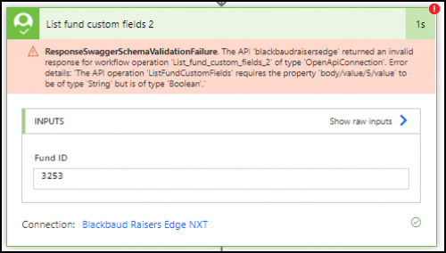

Bug in Power Automate Fund Custom Fields (Single Gift) connector action.
I am attempting to list fund custom fields using the Fund Custom Fields (Single Gift) action, and am getting an error back from the Power Automate connector. I should also note that I have created a custom connector that I use for most of my API tasks, and I receive the same error using my custom connector. If I use the "Try It" link in the developer portal, or if I build an http request and supply a valid bearer token, I get a 200 response.
