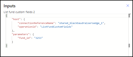

No matter how I pass the ID, it tells me that it received an integer. I have even wrapped it in the string() expression, but no dice. Here are a few screenshots of a test.
For this test, I just typed in the id of one of my constituents.
Here is the error message:
It's a little blurry, but it says:
However, when I look at my raw inputs, it looks like a string:
Are others experiencing this behavior?
I've done some tests and believe this might be a bug, especially since it seems to have started happening right around the time that the newest updates to the connector were released.
ResponseSwaggerSchemaValidationFailure. The API 'blackbaudraisersedge' returned an invalid response for workflow operation 'List_constituent_custom_fields' of type 'OpenApiConnection'. Error details: 'The API operation 'ListConstituentCustomFields' requires the property 'body/value/2/value' to be of type 'String' but is of type 'Integer'.'

Ben Lambert, I'm having the same issue with the Fund Custom Fields (Single Gift) action. I can create an HTTP request with a valid bearer token, and it will succeed. If I use your connector, or a custom connector I created from your Open API spec, it fails with the same error seen on this post, EXCEPT that it tells me that mine is of type 'Boolean'.1
I tried the same tests as Ben Regier. I changed from using a dynamic value to a hard-coded value, wrapped it in a string() expression, etc.0
