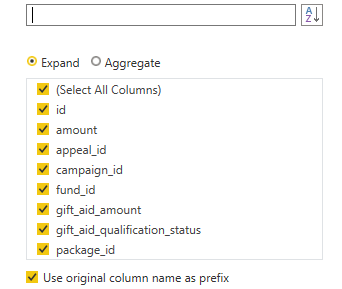

I have not been able to find a way to link Gift Appeal to gift using the Power BI Connector. Without this, I am unable to do the majority of my reporting. Am I missing something?
If you look in the Gift data set you will see a field called "gift splits". When it is imported into Power BI there are some fields that are concatenated into a List. You need to expand that field (double arrows) and you will see the Appeal ID and the Package ID.
