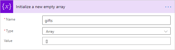

First, I'll initialize a new empty array variable to hold the "augmented" gift items which will include the constituent name (note the empty brackets provided as the default Value for the variable):

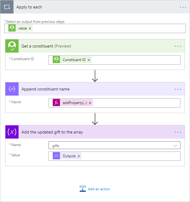

I'll iterate over the results, and within the loop use the Get a constituent action to fetch the constituent details. I'll then use the Compose action to compose a new object (including the constituent name), and then use the built-in Append to array variable action to append that new object to the gifts array variable:
In the above Compose action, the addProperty() function is used to add a new property named "Constituent Name" to the current item in the loop:

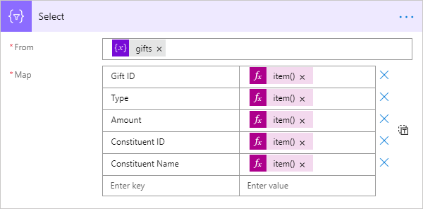

addProperty(item(), 'Constituent Name', outputs('Get_a_constituent')?['body/name'])Now, outside of the loop, for convenience I'll use the built-in Select action to project a new array object (based on the gifts array variable) containing only the fields I want in my HTML table:
The Select actions also allows me to specify more user-friendly column names, and the map formulas I'm using for the column values are:
item()?['id']
item()?['type']
item()?['amount/value']
item()?['constituent_id']
item()?['Constituent Name']

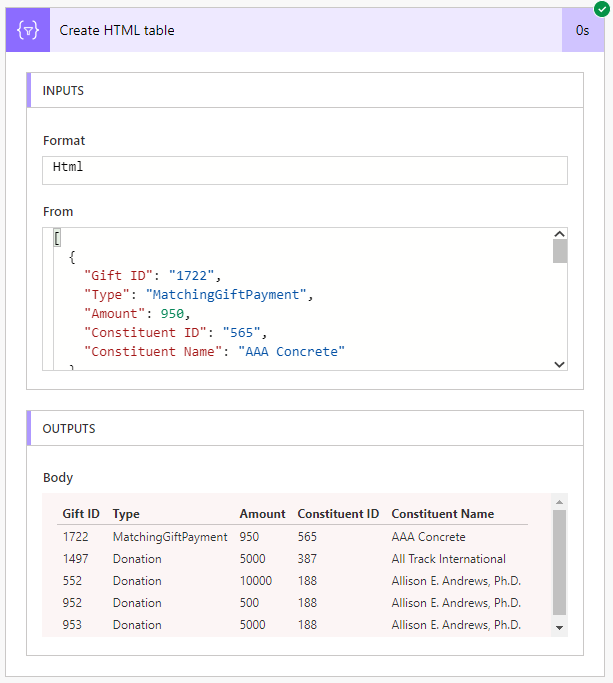

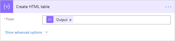

Finally, I use the built-in Create HTML table action to built the HTML table based on the output from the Select action:

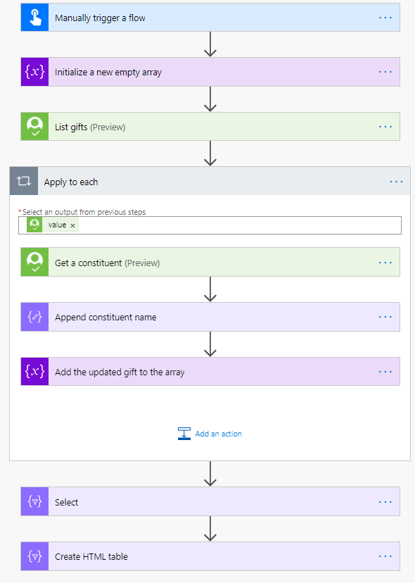

So my completed flow looks like this:
...and when the flow runs, the HTML table will look like this:
