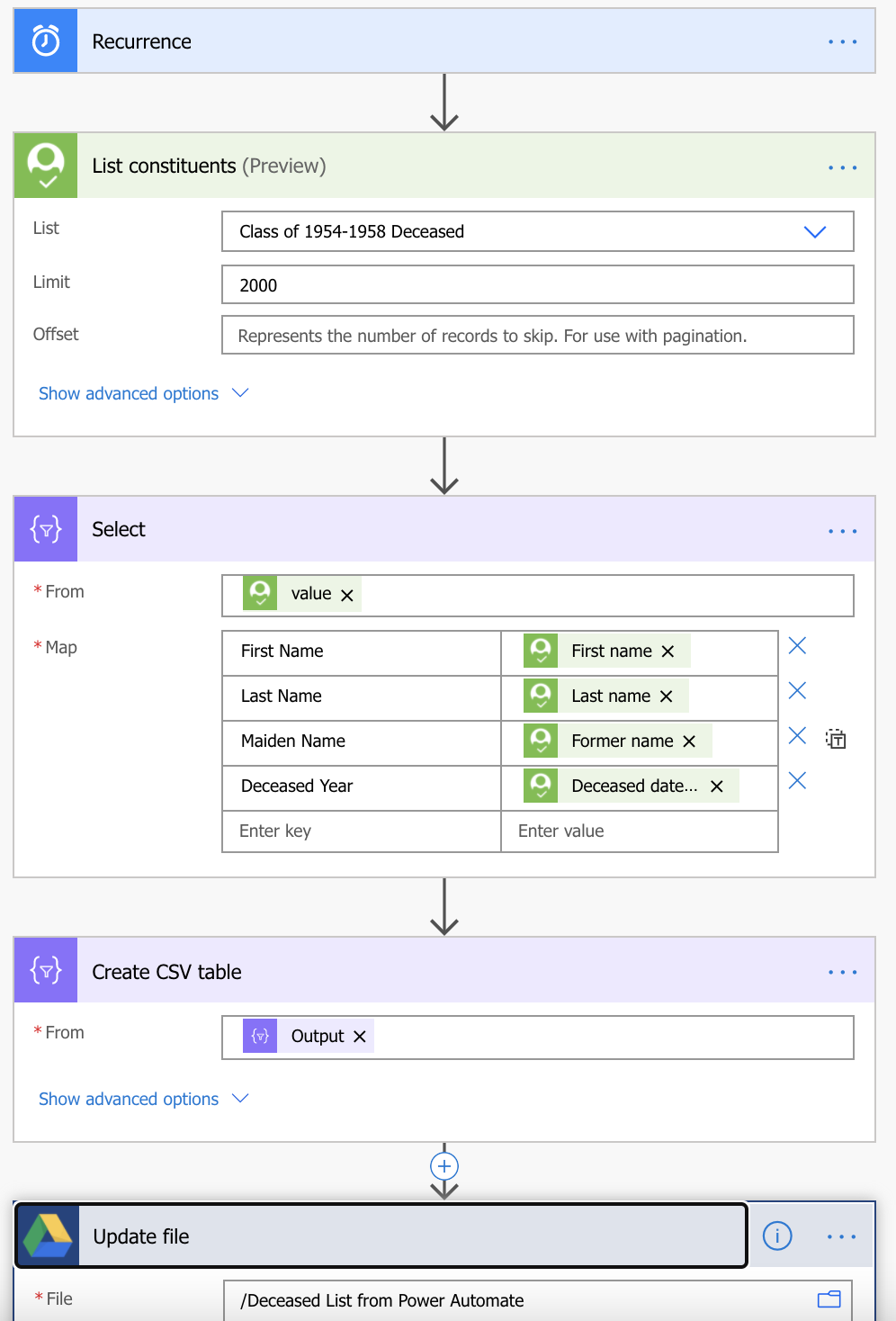

I first took my question to the RE NXT Support, and they suggested I post my question here.
I am new to this, and I am trying to set up a Microsoft Power Automate flow that will grab the data from an RE NXT list and sync it to a Google Sheet. I have all accounts connected (RE NXT to Power Automate and Power Automate to Google Sheets), but I'm not having any luck getting the data to sync. How should I properly set this up? I'm attaching a screenshot of my flow setup. Any help would be greatly appreciated, thank you!

If you're just hoping to keep the csv in sync, I'd suggest that you follow the advice from this thread.
If you're wanting to add new rows as you go, you'll need to start with a For Each loop for PA and put an Insert Row statement inside of that. You can get pretty close by following our Gift Notifications demo.

Your post was incredibly helpful, thank you so much for taking the time to respond. One issue I'm running into is that when I select the "Deceased date" dynamic field, it is formatting it like this in Google Sheets: {"d":24,"m":1,"y":2005}. Is there anything I can do on my end to correct that formatting?
I'm attaching a screenshot of my working flow so that hopefully it will help someone in the future if they stumble upon my post!1 -

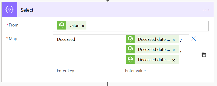

The simplest way to do it would be to use the day, month, and year dynamic content instead of trying to use the full date. Then you can build your date like this instead:
As you can hopefully see (even though the field names are truncated), I'm selecting the individual day, month and year, and then putting a backslash between them. In your example, this would display as 24/1/2005.
The caveat is that if one of the elements is missing, you'll get a strange-looking value. If there's no month, it will be 24//2005, etc. This may have implications if you're trying to put this into a column in your Sheet that is expecting a date value, as 24//2005 is not going to validate as a date. If not, this may be good enough for your purposes. If your date needs to validate, it will be a more complex process of checking which elements are present and supplying default values in case they are not.2 -
