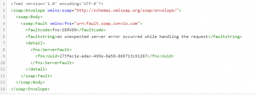

Thank you for your advice. We have been able to retrieve the Donation and DonationCampaign endpoints though we are having trouble with the TransactionSummary endpoint. We are receiving a generic error when we try the following queries:
select * from TransactionSummary limit 50
select * from TransactionSummary where date = 2024-08-01 limit 50We have successfully queried other records so we know the general structure is working but the TransactionSummary endpoint keeps throwing us that error.

@Chris Chang TransactionSummary is not something that can be queried by itself. It is an embedded type that can be targeted when calling on Constituent
It pulls the data from the constituent record under "Transaction Information"
See:
FirstTransactionType TransactionSummary.
LastTransaction
A transaction summary of this Constituent's most recent monetary transaction.
LargestTransaction
A transaction summary of this Constituent's largest monetary transaction.
