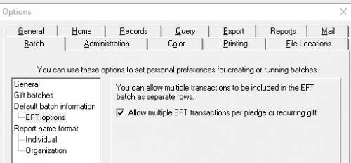

Are you using that query to “automatically generate transaction payments” in batch tools?If so, do you have the same batch settings? There is an option for schedule on the default tab. Did colleague somehow change the number of installments there?
Or when in batch Tools > User options > batch tab has this option. This is my guess, not checked for you, but is for colleague.
Just some possibilities.
@JoAnn Strommen
Yes we were using the same query.I tried your suggestion and it worked perfectly! We had different settings there. Thank you so much!
