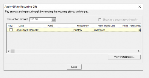

  • @JoAnn Strommen All great questions: Yes, GC does have the correct fund. We double checked to make sure they were in the drop box and they are. I download the form as an excel document and then import it into the batch. When doing the batch, when I hit apply, I find the recurring donation, it has the fund listed there. Here's a screenshot for an example:
    13929d1b6a2612c0887596ca20a73533-huge-sc
    Once I click the correct recurring gift, (you can see the checkbox on the left and the fund is listed) it will generally fill in all the information in the batch. The fund is tied to the campaign so it's odd that after I click the correct gift, the campaign will populate but not the fund. Not all the gifts do this. Trying to figure out why it does this on some funds and not others.

    @Keeley Hanson I had this issue before. It was due to a user option…fund pulling from fund ID as opposed to the fund description I normally use in batch. Once I changed it, the batch populated as expected.
