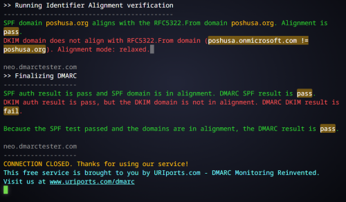

@Philip Nawrocki Thanks for the information. I did run a test and it seems that we pass but had
an error see text in red on the below screenshot.
DMARC Results
--- Connection parameters ---
Source IP address: 2a01:111:f403:2409::701
Hostname: mail-dm6nam04on20701.outbound.protection.outlook.com
Sender: marteaga@poshusa.org--- SPF ---
RFC5321.MailFrom domain: poshusa.org
Auth Result: PASS
DMARC Alignment: PASS--- DKIM ---
Domain: poshusa.onmicrosoft.com
Selector: selector2-POSHUSA-onmicrosoft-com
Algorithm: n/a
Auth Result: PASS
DMARC Alignment: poshusa.onmicrosoft.com != poshusa.org--- DMARC ---
RFC5322.From domain: poshusa.org
Policy (p=): quarantine
SPF: PASS
DKIM: FAIL
DMARC Result: PASS--- Final verdict ---
DMARC does not take any specific action regarding message delivery. Generally, this means that the message will be successfully delivered. However, it's important to note that other factors like spam filters can still reject or quarantine a message.---------------------
Thanks for using dmarctester.com
This free service is brought to you by URIports.com - DMARC Monitoring Reinvented.0 -

@Philip Nawrocki I'm uncertain about the specific procedures involved in DKIM and DMARC, but I do have some questions: Assuming my IT department has correctly configured DKIM and DMARC, what additional measures does Blackbaud need to take to complete the authentication process?
Essentially, I'm seeking clarity on where the responsibility lies for resolving any troubleshooting issues—is it primarily on our end or theirs?
@Jeffrey Simpson Can you tell me if the error needs to be fixed on my DNS server or Blackbaud?
@Magdalena Arteaga check these out:
https://bobcares.com/blog/dkim-result-fail-bad-signature/
https://powerdmarc.com/why-does-dkim-fail/
On this one look at DKIM Authentication Result Failures, number 2. That points towards BB.Thanks,
Phil
