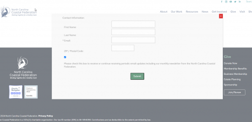

view of popup: (link https://www.nccoast.org/thank-sharing-adventure/)

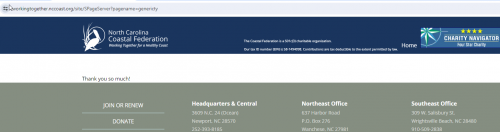

view of thank you page that loads OVER my original page: (now my user is lost)
