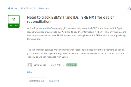

To add to my confusion, I looked in the Idea Bank and that site says this has not only already been requested, but shipped--which means it should be in the record somewhere, right?
