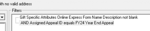

ThanksIf you know which appeals you are looking for specifically, that will help! I would do a constituent query of people who gave online - whatever criteria would help you find those constituents. For instance, if a donation is made using Online Express, an Attribute will be added to the gift.
After you've established that first piece, then look under Assigned Appeals in Query. That is where you will look up the specific appeal. This is what it might look like:
That would pull constituents who have a gift made via Online Express AND who also received the FY24 year end appeal.
Hopefully that points you in the right direction!

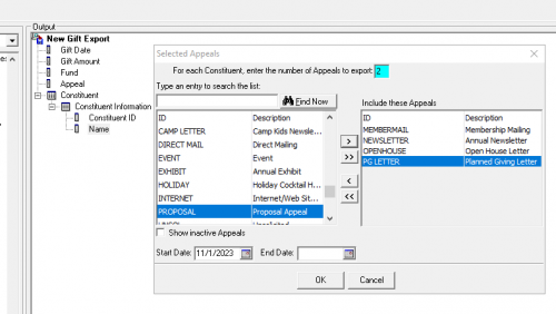

@Jeanne Fogel In addition to @Karen Diener's suggestion, you may want to link a Gift query of your OLX gifts to a Gift Export and then select only the Appeals that you want to see there. Then you can just review your most recent Appeals, but you can look at more than one at a time.
