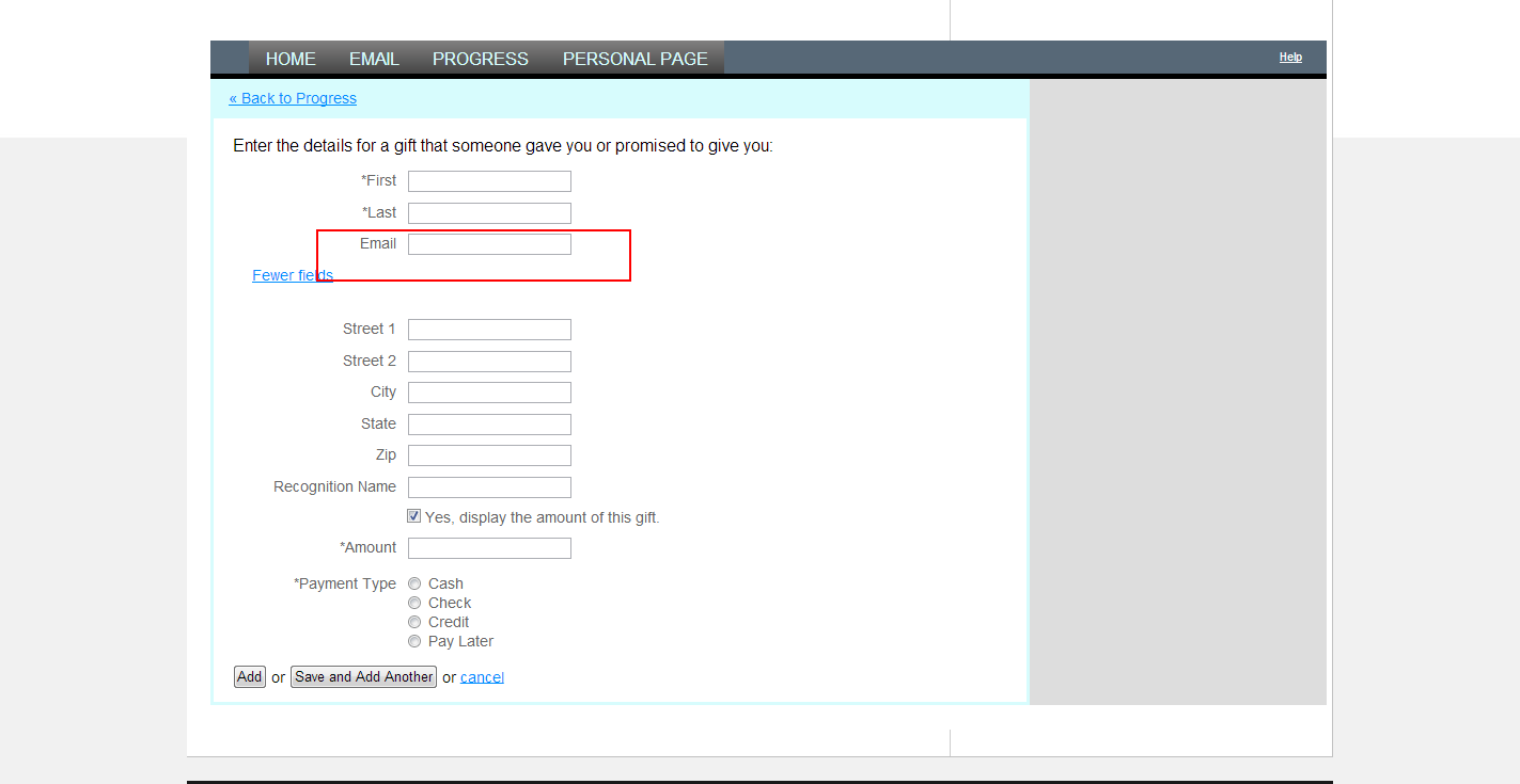

Is there a way to require email addresses when someone is registering an offline donation in their Teamraiser participant center?
We want to avoid donations coming through without email addresses for donors.

Try this... Go to Fundraising > TeamRaiser > Participant Centers and click to edit the appropriate Particpant Center. On step 2, Configure Options, click Edit Custom Javascript under related actions (below the left nav)
Paste this at the bottom of the custom code:
function requireEmail(){
document.getElementById('gift_email').outerHTML = '<input type="text" id="gift_email" name="gift_email" class="required">';
document.getElementById('msg_cat_gift_email_label').outerHTML = '<label for="gift_email"><span class="required">\\*</span>Email</label>';
window.onload = requireEmail;I didn't test this too thoroughly so run through a few tests before you go live.

In retrospect I definitely agree that disabling the option to add offline gifts isn't the best practice, but I can see the benefits of requiring the email address. It's really annoying when you have to edit a record created by someone entering an offline gift with no email, since the field is required... Their "accepts email" field is automatically set to "no," so we wouldn't have to worry about suppressing them. While we can't email them directly, they will receive the "offline gift thank you" autoresponder, which could have some onboarding language asking them to subscribe.

Chris--this code worked! to require email addresses when recording donations! Thank you! We didn't need to consider disabling offline donations thanks to your solution!Try this... Go to Fundraising > TeamRaiser > Participant Centers and click to edit the appropriate Particpant Center. On step 2, Configure Options, click Edit Custom Javascript under related actions (below the left nav)
