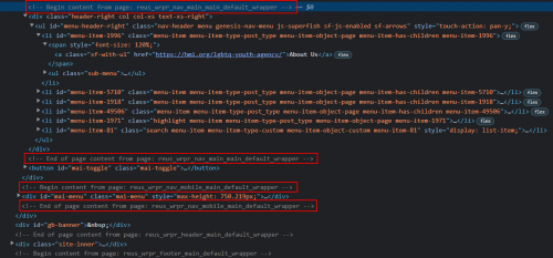

I checked out the Org's website listed on your profile and specifically the donation page. There is a trick that everyone should know, especially if you're trying to hunt down the location of something in Luminate Online. That trick is to navigate to a front-facing page that is built in LO (donation form, Pagebuilder page, Survey, etc) and then add &s_debug=true to the URL as a URL parameter. Once you do that, hit ENTER to go to that page. At that point, if you look in the source code, you will now see HTML comments that specifically tell you where things live/where reusable pages start and stop. This can help you identify where specific code in the Pagewrapper lives.
Example of your site:
Edit: Sorry, didn't know the forum would resize the photo so much. Hard to read. What most developers in LO do, including myself, is create a series of pages in Pagebuilder that include snippets of code (headers, navs, footers, sidebars, etc) and then include those things on the Pagewrapper itself as reusable pages. This makes re-using certain elements across several Pagewrappers more manageable and easier to update.
After looking at your donation form, I can see that there are several Pagebuilder pages which make up the Pagewrapper, at least for the donation form.
There are two pages that I see which would have navigation items in them:
reus_wrpr_nav_main_main_default_wrapper &
reus_wrpr_nav_mobile_main_default_wrapperThis is likely where the items you're looking for live, inside Pagebuilder.
