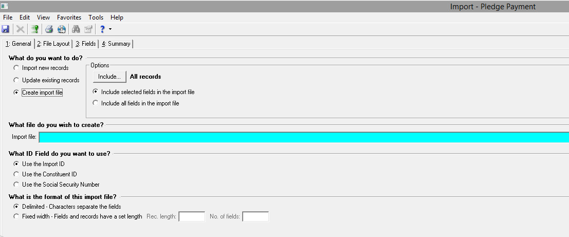

The end result will not have a lot of data to view, but what you can do is use an import to create your data file. I use this when I'm converting clients from RE to something else.
It is a Gift import and you specifically want Pledge Payment. Have a query ready of your pledges, and use that in the “Include” section. That will only appear after you have selected the radio button of “Create import file”.

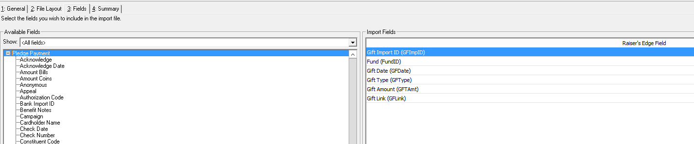

I'm not sure how familiar you are with importing, but on the “Fields” tab, you'll list all of the fields you need for your new system. Make sure that you keep the required fields in place too:
On the left are the fields that will show - by default - in the final file. GFImpID is the import ID of the pledge payment, but the equally important field is “GFLink”. That is the import ID of the original pledge, and that is how you can tie a pledge to a payment.
Hopefully that is enough to get you started. Do some testing first to make sure you understand what is going on, and even try a test run in your new database if at all possible. Send me a direct message if you run into a huge snag and I'll see if I can help out.

I tried this technique, but end up with an empty data file when I click Create Now. What step might I be missing?
