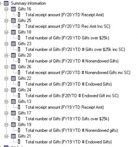

Is there anyway to copy Summary Gift Field in Exports?
Unfortunately, not. We do create a generic export with 20 years to reuse and just remove the ones we don't want. You still need to go into the criteria but much easier than starting from scratch.3
Would have been so helpful but unfortunately no.0
I have given this advice many times over the years: in a lot of cases like this, I feel like exporting all the gifts and doing the calculations in an external program is quicker and more reliable. For smaller exports, SQL server or whatever you're hosted on will do these calculations quickly. But for larger exports or ones with many summaries like this, it just takes a long time. add to that that you can't see the criteria easily without opening up every summary, and it's really easy to make errors that you can't see till your results are obviously wrong somewhere.
Exporting all the gift info and then, for instance, setting up a bunch of SUMIFS formulas in Excel -- especially now that power query is included in excel by default -- is going to be easier to read and easier to troubleshoot.3 -
