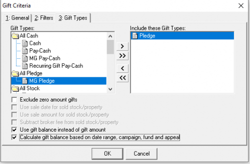

Try Summary Information -> Total Gift Amount. Enter your date range on tab 1 (General) and on tab 3 (Gift Types) try this:
I don't have data to test whether or not this will give you what you're looking for, but it's the only thing I can think of that would get close to what you're looking for. Experiment with adding Pay-Cash to the Gift Types.0
