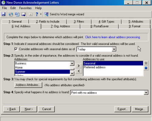

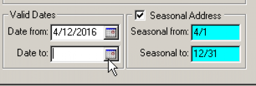

You are correct about the start and end dates. Use a month/date format. If the constituent goes to their seasonal address on December 5 and returns to their home address on March 4, your start date is 12/5 and your end date is 3/4. To leverage the address dates, when you run your letters look to Tab 6 and prioritize seasonal addresses over other addresses. If today's date (Step 1) is between the seasonal address start date and end date, the seasonal address will print on the letter.

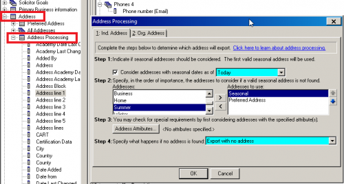

You can accomplish this same goal in Export using the Address Processing node.

Thank you so much Aaron! The missing link was the order on tab 6. This will help me tremendously! What if you don't 2 addresses but you do know that one of them is seasonal. Will it omit the seasonal address if it doesn't fall in the correct date range?0
"Will it omit the seasonal address if it doesn't fall in the correct date range?"
Correct! The start and stop dates on the seasonal address is what makes it work.1 -

Also, I find it helpful to add the seasonal dates as a columns on the constituents address records.
Just right click somewhere in the address tab/ Columns. Then move seasonal from/to over to the right0 -
