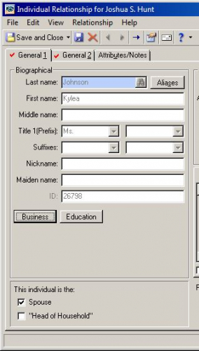

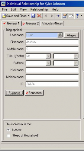

So I just test married myself to a coworker in NXT. When I go to the database view, neither of us is HOH.
PS I could be losing my mind but I see no way to mark one of us HOH in NXT.1 -
Was the box available to mark one of you HoH in database view? And was the Spouse box checked after your 'marriage' in NXT?0
Larry Wheeler:
Was the box available to mark one of you HoH in database view? And was the Spouse box checked after your 'marriage' in NXT?As far as I can see, there's no HOH box in NXT. Do you guys have it?
Yes the "Spouse" box is checked and shows up on my record in the "Spouse" box on Bio1

Yes the "Spouse" box is checked and shows up on my record in the "Spouse" box on Bio1I was talking about Database view for both questions. I was curious if the HoH check box was even showing up.

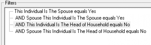

First, thank you for finding this, Kylea Johnson! Second... I think I have a query that will work for you.
It's a constituent query and kind of a weird one. Here it is:
So.. I went to the Individual Relationships of the Constituent, and chose "Spouse = Yes" and "HoH = No"
and then....
I went to the Individual Relationships under the SPOUSE tree and chose "Spouse = Yes" and "HoH = No"
It essentially finds people who spouses to each other ("Yes and Yes") and people who are NOT the HoH to each other ("No and No")...
And, sure enough, we found two recently entered couples who had a NO in both the HoH fields.

Thanks for the query, it seems to do the trick.

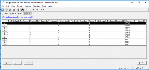

I just tried Tom Klimchak's Query and got a handful of records, all of which have non-constituent Spouses (which wouldn't get an HoH flag anyway).
Curiously, most but not all, return a "duplicate."
I'm not finding anything that these records have in common or any reason why some, but not all, non-Constituent Spouses are returned by the Query.

Did you check the relationships tab for an identical spouse entry who is a constituent? I didn't have any non-constituent spouses show up when i ran the query and I know we have non-con spouses.
Larry Wheeler , I did check for duplicate spouse entries. One had a second Spouse relationship type, but the others didn't. Ultimately it shouldn't matter because the Query isn't looking at the Relationship Type. It's looking at the Spouse flag which should exist on only one Relationship record.2
