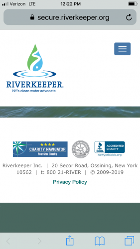

What would be the trick to getting the default 'Monthly Donation' to work? I've set the default amount and Pre-Selected Gift Type within the form, but only the amount is coming through.
https://secure.riverkeeper.org/site/SPageNavigator/Blackbaud_checkout.html
