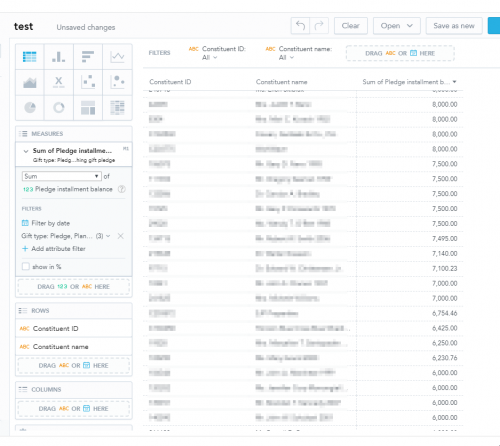

I think I created something which show you pledge balance, but it's not perfect. Here's what I did:- I created a new Table insight.
- I dragged Pledge Installment Balance into the Measures area and chose Sum (probably automatic).
- I click Add attribute filter and chose Gift Type. I chose Pledge, Planned Gift and Matching Gift Pledge.
- You might now see a total of all your open pledges.
- To get further detail I dragged Constituent ID and Constituent Name into the Rows area.
Does that help? Or at least get you started?2 -

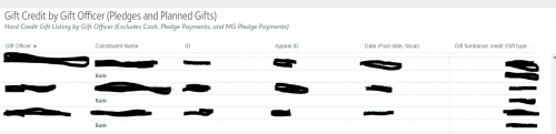

I ended up playing some more with the solicitor credit insight and broke out pledges and cash (no pay-cash) into separate reports. It's not ideal (like the canned RE report can be for this) but it will do the trick for now. Images attached in case they can help anyone else-
Melissa1
