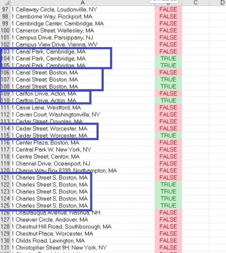

Hi Carolyn-
My approach would change depending upon how the data is stored in your database, but assuming you have three constituent records, one for each parent and one for the child, I would output every constituent in your entire database (you could also constrain the query by Constituent Code to get just parents and children) with their Preferred Address Street 1, City and State. I would then concatenate Street 1 with City and State so that one Excel cell will contain [Street 1, City, State], then sort by that column, then use Excel's Exact function to find folks at the same address. If you include the primary Constituency Code as a column that will help you locate parents and students that live at the same address versus two parents where there is no child. Add in some conditional formatting with colors to quickly find your Exact matches.
The formula in cell B98, for example, would read =EXACT(A98,A97).

The formula in cell B98, for example, would read =EXACT(A98,A97).2 -
If you're data is not super clean you might want to do looser comparisons. Once the data is downloaded to Excel, you can concatenate the first 6 or 8 characters of Address Line 1 and the first three characters of city. Then you could match records like: "1020 West State Street" and "1020 W State St".2
You might consider using AddressAccelerator or having your entire database screened with NCOA and update the address formatting. Then your Excel formulas will work better, and your database will be cleaner!3
