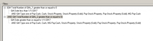

Be sure to consider gift type also - do you want pledges or only paid gifts?Paid gifts. If I do that merge shall I plug into the report afterwards? I just want the most accurate number.
The trouble with using First Gift and Last Gift is that it will do exactly that - there's no way to tell query to look at the first gift from a particular list of types. I would do two summary criteria: total number of gifts prior to 1/1/17 > 0, and total number of gifts on or after 1/1/17 > 0, making sure to also select the applicable gift types for each summary.7
Yep, thought about summary also.
With constit query, First Gift category does have a criteria field of Gift Type but it may not filter like expected. ?0 -
You've got "greater than or equal to 0"; it should be "greater than 0" otherwise you'll get everyone regardless of whether they're given a gift or not
JoAnn, no the first gift type filter doesn't work the same way in query as it does in export - if someone's first gift is not one of the selected types, they won't show up in the results at all. Not like in export where it keeps looking until it finds the first gift of the relevant type.5 -
You should not have to, but you might want to try it with ( ) around the criteria (for each summary of gift)
I'd also suggest, running just the number of gifts since 1/1/17 to see how many your total is, then the total of people that have also given prior should be less than that number so at least you know if you are heading in the right direction0 -
great eyes Alan!
Did not see the 'or equal to' - of course that is why the number is so high2 -
Alan French:
JoAnn, no the first gift type filter doesn't work the same way in query as it does in export - if someone's first gift is not one of the selected types, they won't show up in the results at all. Not like in export where it keeps looking until it finds the first gift of the relevant type.ah yes more realistic number now. Thank you!
