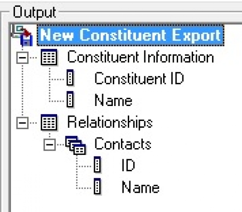

The screenshot below is from a constituent export that gives me 4 columns: the organisation's ID and name, followed by their contact's ID and name (you can add more columns for extra contacts if requried).
If the contact name is present but the ID column is blank, it may be that the contacts are non-constituent relations?
Thanks Alan, I’ll give this a whirl...
Foolishly, I haven’t tried export, only query so perhaps this is the answer!Best
Georgie

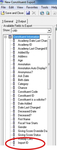

If you do decide to do an import of existant constituents into an event I believe you will need the Import ID, not the Con ID and that is something you can export as well
Here is a photo of the Import ID I am referring to:

Hi
Thanks for getting back to me. When I do it that way, the only things I can export are the Individual relation import id and the individual relation individual import id? It doesn’t seem to work with either?

I have the event set up and the organisations on there, it's just the guests of the organisations that I want to add. I know how to do this if I just want to add them as participants that are not linked back to the full constituent record, I'm just struggling to make it work when I want them fully linked. I've read the import guide and tried what it suggests but still no luck.
It is the constituent import ID that I'm looking for rather than the regular cons id (sorry - unfortunate typo in original message!)
