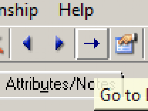

FYI if you haven't found the Go To button...it's the blue arrow with the tail. Found on a number of different records, like on Gifts that will take you to the associated Pledge or Payment or Constituent (especially helpful for soft credits where you are opening the Gift from the soft-credited constituent's record).
