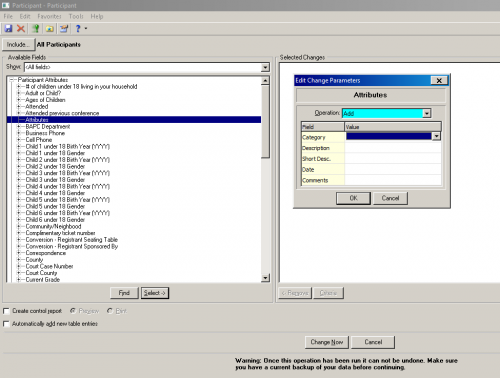

Is it possible to globally add an attribute to a group of participants?
I didn't see it as an option in Global Add. And for Global Change, it won't add it because the attribute doesn't already exist on the record.
Any way I can work this?
How to globally add attributes to participant records ... Create a participant query of the participants to update. ... Under Available fields, select Participant Attributes, Attribute.
