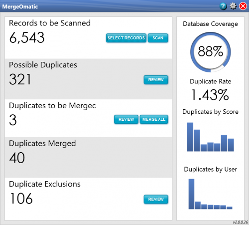

  • Hi Folks, if you're struggling with dupes in RE -please- try the 30-day free trial of MergeOmatic (or at least watch the six minute video here). To answer OP's question, you can easily mark records as not dupes (as well as see them all/change some back again if you later decide they are dupes). It also does a much better job of finding/ranking/displaying possible duplicates than anything else. If you like, one employee (or volunteer) can review the dupes and queue them for merging, and then a supervisor can review the queue before merging in batch. It also creates a confidence score for the matches, so you can sort and filter to work with the "low-hanging fruit" first. Finally, it archives practically all the data from the merged record so you could go recreate it if you ever had to (and you'll have a full record of who was merged into who when). We spent years of developer time working on this solution, if you're glad to see someone working on this pervasive problem, please click "good answer" above. I look forward to hearing your feedback!

  • Hmmm the free trial does sound tempting. Thanks.
