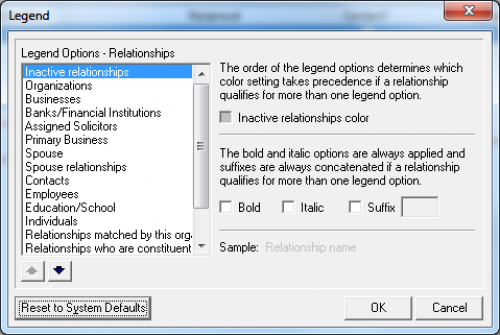

To help viewing only the active Solicitor(s) on the Relationships tab, we use a Legend color of a pale grey for any "Inactive relationships."3 -
I love the color legend and I do that too.
